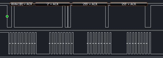

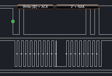

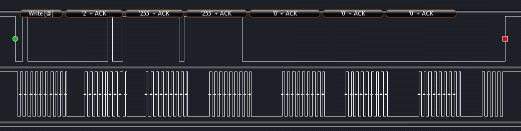

I have found what I believe to be a bug in the I2C code in V4.2
Im using a Netduino Plus and programming in VB.
This is the code;
Dim BytesSent As Integer
Dim con As I2CDevice.Configuration = New I2CDevice.Configuration(64 >> 1, 200)
Dim MyI2C As I2CDevice = New I2CDevice(con)
Dim data As Byte() = New Byte() {2, 255, 255}
Dim xActions As I2CDevice.I2CTransaction() = New I2CDevice.I2CTransaction() {I2CDevice.CreateWriteTransaction(data)}
BytesSent = MyI2C.Execute(xActions, 1000)
The problem is to do with the selected clock speed.
If I set the clock speed in the configuration line to 100 I get badly formatted data and that is probably because the clock is only actually running at about 95 Khz See first Attachment.
If I then change the clock to 150 I get correct data but 3 extra bytes are added to the end. See attachment 2.
Then if I use a clock speed of 200 or above I get the correct data as shown in attachment 3 and all works as expected.
I have also found that sometimes the Netduino fails to send anything at all, and I have to power cycle it to get it working again.
Can anybody explain this?
