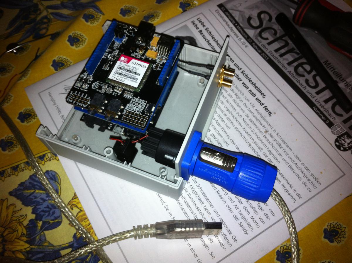

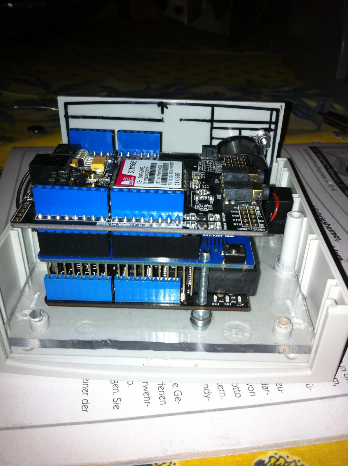

#50052 Community Netduino case ?!
Posted by nhale on 28 May 2013 - 10:32 AM in General Discussion
I know there are some topics about the "case" topic, but my intention is a little bit different.
Let me explain.
I bought a case from an electronics supplier, which is not specifically made for a netduino or arduino. For my prototype it works fine, but now I'm searching for a case which fit's to some of my needs.
1.) What I found was the e.g. the duinoCase-NP which looks nice, but is too small for my needs. And btw. is not available in Germany ;-(
2.) Others I found are made of thin plastic, which might break when used in rough/harsh environments.
3.) A self-made case would be the ideal way, but might be very costly for just 2-3 units. On the other hand I'm not good at CAD or whatever the manufacturer requires.
As this is a community, isn't there a way that we build an extendable case which can be used for several use-case - together?
As several cases only work for the Netduino itself or maximum 1 shield, most cases don't work if you are using 2 or more shields. On the other hand in most cases they are so small, that even adding some additional wires and plugs is very hard or impossible.
------ IDEA -----
    [*]Build a case which can be stacked, like the shields do. Take a look at this one from thingiverse. That's somehow the groundplate, which contains the Netduino and how it could look like.
    [*]Additionally there could be some extension units, like 19" cases, in different heights which can be mounted on top (1 height for 1 shield, 2 heights for two shields etc.)
    [*]And then there is another cover on top. That's it...
    [*]To make it usable for different scenarios, some space on the side and back to be able to add additional stuff inside (cables, plugs)
    [*]If it's made of plastic, everybody can drill an additional hole.
    [/list]
    As an example what I mean with space for additional plugs and wires, I attached the current version of my project. There you see the height of 2 shields and that there is little space left.
    I just need some connectors which are reliable when it comes to vibrations and movement. Additionally there are two more connectors planned and 3 LED's.
    What do you think, anyone good at CAD or knows someone who can built it using injection molding or similar...
    Additional ideas are also welcome. Maybe describe what are your special needs and how do you think they could be solved generically?
    Maybe also SecretLabs could produce and sell it ;-)
