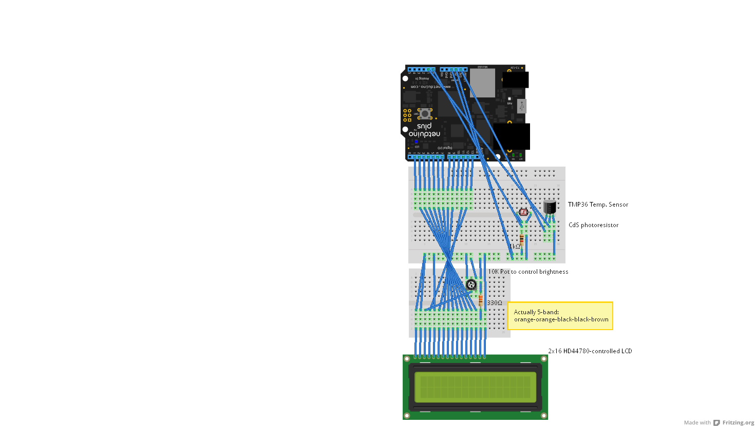

#13831 Sensors cross effect
Posted by Traveling Tech Guy on 31 May 2011 - 07:23 PM in General Discussion
About the Fritzing resistor colors.
The Fritzing drawn resistor is a 330 Ohm, granting an error within -/+ 5%. Orange is 3, black is zero and the 5% tolerance is gold.
The resistor you used is much better: -/+ 1% (last ring brown). Since its precision, it has a ring more, so: orange-orange-black-black ==> 330.0
About the strange value.
I noticed a strange jitter on the ADC readings on my Netduino PLUS, when the ethernet cable is plugged-in. As soon you unplug, the readings are stable. No workarounds, maybe an average.
Could be that?
Cheers
Mario,
My problems started before I added the Ethernet/network component (as you could see in the video) to the equation, and it keeps on happening now.
As for the resistor coloring in Fritzing - I realize both representations end up as 330 Ohm. I was just wondering if I could have Fritzing draw my actual resistor (i.e. 5 rings), rather than a similar one, or do I need to manually add a part?
Thanks,
Guy
#13830 Sensors cross effect
Posted by Traveling Tech Guy on 31 May 2011 - 07:19 PM in General Discussion
Hey Guy,
If you move your 2 analog inputs to analog pins 4 and 5 (instead of 0 and 1), does that change anything?
I know it sounds like an odd request. :)
Hi Chris,
I tried your suggestion (temp. sensor A4, light sensor A5) and got the opposite result: when I shine a light at the light sensor, the temperature reading now jumps up considerably. I get readings of 230C in my room (luckily, untrue :) ).
The temperature sensor then proceeds to go up and down in a loop. It won't reset back to the 22C temperature unless I remove the flashlight.
But the cross effect is still there. May ask what were you anticipating?
Thanks,
Guy
PS: Something else I just noticed. After transferring the temp. sensor from A1 to A4, it now jumps up and down over the span of 4C, even without me doing anything. It's like something else on the board "irritates" it.
#13785 Sensors cross effect
Posted by Traveling Tech Guy on 30 May 2011 - 08:41 PM in General Discussion
Still messing about with my Sensors project. Reminder: light sensor + temperature sensor + LCD - posting to Pachube.
Everything works well now, and updates the Pachube feed correctly. My next step would have been to use Szymon's shift register idea, to go down from using 10 pins for the LCD to 3 pins.
Only while taking a Youtube video of my creation, I noticed (and documented) an undesired behavior: if I shine a bright light at the light sensor, the temperature drops considerably (from 20C to 14C) and jumps back up when I move the light away.
Logically this has to do with resistance (as the resistance in the light sensor grows, it lessens in the temp. sensor), and with some co-dependency in the way I wired the circuit. But I'm not experienced enough to find the root cause.
So here's a Fritzing diagram of my board (again, pardon the wire mess and 2 boards - it'll hopefully go away soon). The two sensors are on the lower left, and are connected as follows:
- TMP36 temperature sensor: right leg -> GND; middle leg -> analog1; left leg - Netduino 3.3V
- CdS light sensor - right leg -> Netduino 5.5V; left leg -> analog0 + 1kΩ resistor to ground
I figured since one sensor goes to 3.3v and the other to 5.5v they are separated. But maybe I've mixed the GNDs?
The code, as well as the full Fritzing file, can be found on github. The video can be found on Youtube (the effect can be seen at 1:48 into the 3 minute video).
As always, any help appreciated. And as always, I'll learn
Thanks!
Guy
PS: Fritzing question: I have this 330Ω resistor connected to the LCD at the lower part of the screen. Fritzing shows it as a 4-ring orange-red-brown-gold, while in reality it's a blue 5-ring orange-orange-black-black-brown. I guess they amount to (almost) the same thing, but how can I tell Fritzing to draw the right one?

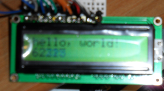

Posted by Traveling Tech Guy on 13 May 2011 - 11:05 PM in General Discussion
SOLVED!
Well, what do you know? It was my $#itty soldering after all!
After racking my brain, re-wiring the LCD, checking each line of code and visiting tons of blogs (thank you all),
I finally went back to basics: I bought a real soldering station and got rid of the Fry
s $10 house burner. I also got a nice solder sucker.
I de-soldered all my connections, re-soldered them at 700F, re-wired one last time, and presto! It works. Attached image proof :)
Thank you all for your suggestions, and for getting me to get a potentiometer. Now to wire in some sensors :)
Guy

Posted by Traveling Tech Guy on 13 May 2011 - 08:54 PM in General Discussion
Update 5/13: Just received my 10K potentiometer, and wired it as follows:
LCD Pin 3 to Pot Leg 2
Pot Leg 1 to GND
Pot Leg 3 to 5V
Turning the Pot does change the LCD brightness, however, I'm still seeing just one row of blocks.
I stepped through the program in VS - nada.
What am I missing here? What's my next step?
Thanks,
Guy
