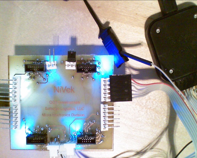

As many of you know- in my spare time (which seems to become a valuable commodity) I've been working on a Netduino GO! based Quad Copter.
I've done a full writeup on my blog The Wolf Bytes and my plan is to do a full series of all the "stuff" H/W and S/W that goes into this as blog posts. When I have some faily major progress I'll update this topic and if anyone has any questions on how this stuff works, please ask them here or send me an email at kevinw@software-logistics.com. My plan is eventually to release all the H/W and S/W as open source, but I'm also considering some alternatives to sell kits, at least for the electronics.
Thanks to Steve Bulgin (beter known as Gutworks) I was able to figure out how to post a quick and dirty video (read as: one take and no editing) to the forum.
In addition, I've attached a picture of the piggy-back board for the GO! main board that contains a few STM8S207's that power the sensors and the flight controls.
Enjoy!
-twb

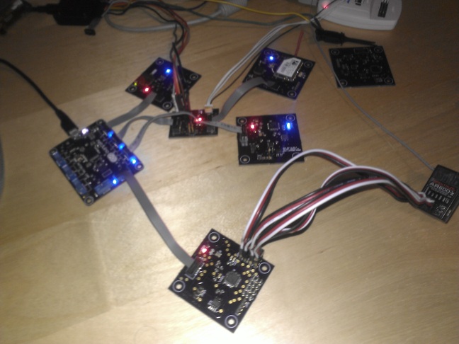

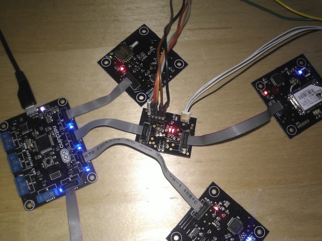

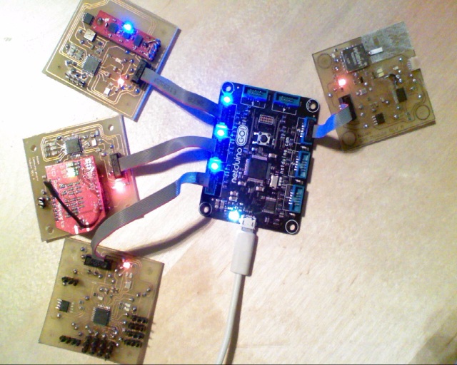

I guess I can add my little family's pictures to this thread. I'm building a Netduino powered Quad Copter called NiVek GO! QC1. More details on this to come.
As you can see from Gen1.jpg, my family started out with humble beginnings on some home made PC boards, although this was kind of fun, creating 0.25mm pads for the gyro's was a bit of challenge.
Next came Gen2.jpg, these where some boards I ordered from OSH Park. They have an awesome service where you can upload your .BRD files from eagle and it shows you a preview of what they will look like. They are very inexpensive as well. Pictured in Gen2.jpg is my sensor module w/ Gyro/Accelerometer/Magnometer and Pressure sensors, it also has a 32K EEPROM. Also a WiFi board, a GPIO board that takes PWM as input and provides PWM output to control ESCs for the motors and finally a WiFi and GPS board.
Finally in Gen3.jpg, you can see my combinded board with all the above modules with the shape as the GO! main board. This one sits on top and uses a ribon cable to attach the modules to the GO! board. Next one will use female modular connectors on the bottom of the board to "snap" the modules onto the main board. Sort like the shields for the original Netduino.
I'm actually getting faily close to wrapping up V1 of this, once I do so I'll publish all the HW/SW. Until then if anyone is interested in getting involved and looking at some of my code, PM me and we'll work something out. I might even have a few spare blank PCB's laying around I can send out for you to populate.

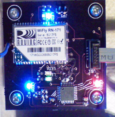

Thanks Chris -
Very nice, ByteMaster!
Here's a pix of a similar module with a RN-171 WiFi module soldered in place. This is the same module on the underside of the RN-VX WiFi module with the same foot print and pin-compatible with XBee modules.
The firmware is starting to become pretty solid, hope to have all the 'stuff' (H/W & S/W) I'm working on published by the end of August.
-twb

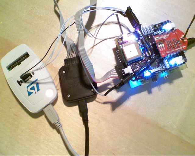

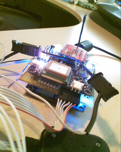

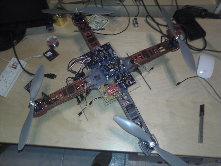

I was able to sneak in a little time into this project yesterday and took a couple of _kewl_ pictures. I think the module concept works really well when prototyping the hardware and writing the software, but the final product turns out to be fairly large. In a final version I can see creating one board with multiple processors. -twb

Unfortunately this projects priority got moved down a bit. With the upcoming launch of Windows 8, a very intersting and what I believe once in a life time opportunity came a long that has been sucking up all my free time :unsure:.
Saying that however, I did spend a little time on this yesterday and I'm really not that far away. the NiVek GO! copter consists of four boards:
- Sensor Board: ITG3200 3 Axis Gyro, LSM303 Accelerometer & Magnometer, BMP085 Pressure Gauge and a 32K Data logger. I've combined the Gyro and Accelerometer into something that gives very stable Pitch/Yaw and sends that back to the GO! main board. I need write the code to read the pressure (to determine altitude) as well as figure what I'm going to want to log to EEPROM.
- GPIO Board: A standard 5 channel remote control will be used to fly the copter (originally looked at just using WiFi but there was too much latency). This board currenly monitors the pulse width coming in from the RC receiver, it also has four outputs that send PWM signals to the ESC (electronic speed controls) that control the brushless motors. Final task here is to build the PID controller that combines the output from the sensor board and RC inputs to control the motors to produce stable flight.
-GPS Board: Just used to track location, this is pretty much done, my board design/ground plane was incorrect for the PCB antenna, but I got that sorted out.
-WIFI Board: Used to send telemetry from the GO! copter to a Windows Phone/Win8 (see pix of initial WP7 app) flight controller app. Also will be used to do in-flight calibration of the PID algorithm and sensor calibration. This is working but I'd like to get a little better through-put on it.

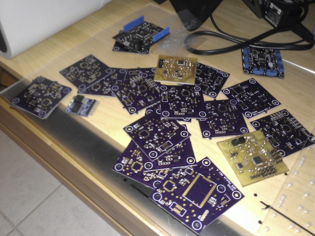

I've also ordered and received a bunch of manufactured boards from OSH Park to replace my home made ones that will be a little more reliable. Also note in the pictures, the board between the GO! mainboard and my WiFi board, it lets me connect my logic analyzer and ST-Link to help with development.
Once I get all this figured out I'll probably just create one larger board that has all the modules in place.
