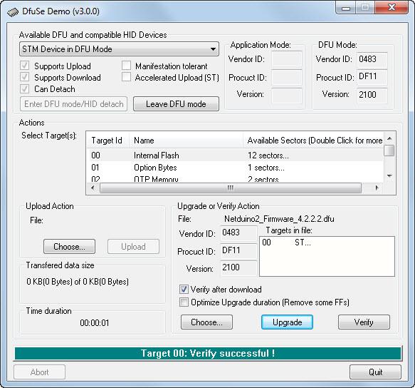

#46118 Netduino 2 frozen
Posted by tjfdownsouth on 23 February 2013 - 12:10 AM in Netduino 2 (and Netduino 1)
I seen the different link to get dfuse in 4.2.2 and used the version 3.0.2 and everything is working now.  Thanks for your help I had to get all the correct versions installed and it worked correctly after that.
Thanks,
Tim
#46011 Netduino 2 frozen
Posted by tjfdownsouth on 21 February 2013 - 10:34 PM in Netduino 2 (and Netduino 1)
Is it possible that i am not using the correct version of dfuse?  The link in the firmware update page did not work so I had quite the chore tracking down the version I have.
Thanks,
Tim
#45921 Netduino 2 frozen
Posted by tjfdownsouth on 20 February 2013 - 09:21 PM in Netduino 2 (and Netduino 1)
Thanks Chris, I tried it again and verified I was in the "Upgrade and verify" pane but still ended with same result.  I have attached a dfuse pic.
Thanks,
Tim
