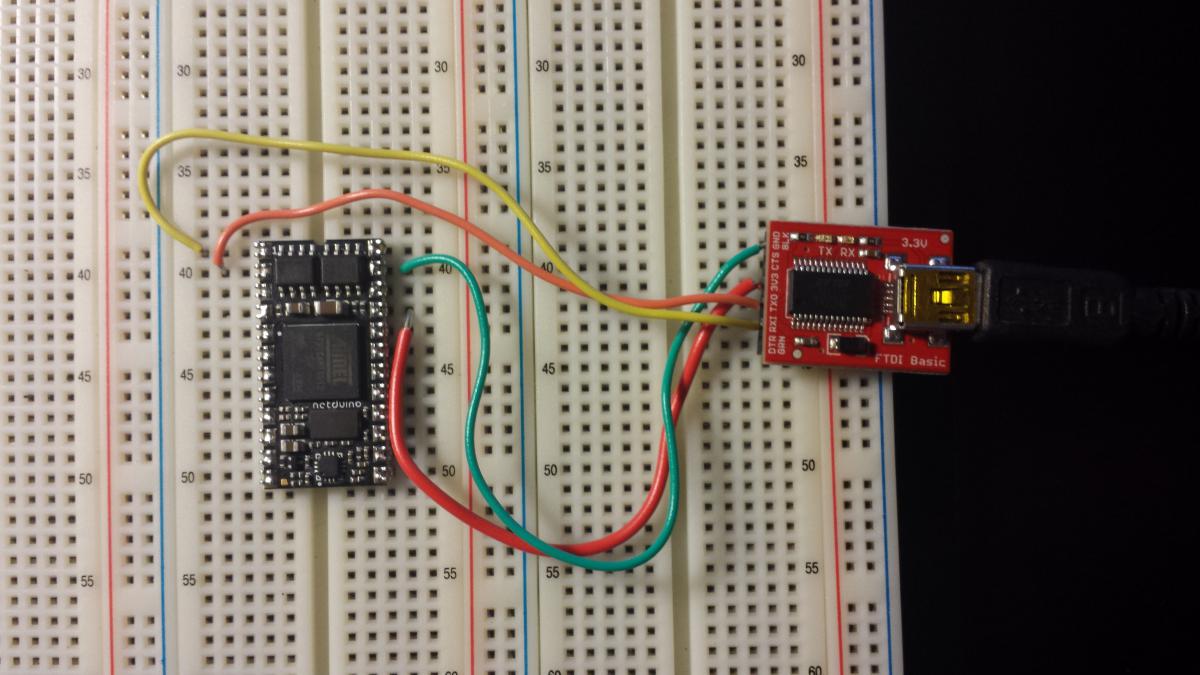

#54587 No response from Netduino Mini
Posted by coose on 10 December 2013 - 04:39 AM in Netduino Mini
Thanks for the response. I was hoping that I had just done something stupid.
The FTDI can be set to either 3.3 or 5V. it came from the factory 3.3, and I set the jumper to 5V. When plugged into USB power, i read 5V across the FTDI VCC and Gnd pins.
I've tried power several different ways. I currently have it powered from the FTDI on pin 21, and grounded to the FTDI on pin 23.
I've rebooted, and tried several computers and several USB cables. I plug in the mini, then launch SAM-BA.
This is a brand new mini. I plugged it into the breadboard and followed the instructions here:
http://forums.netdui...y-instructions/
i was able to change the deployment port to TTL UART (before i changed the FTDI board to 5V). so it was responding. until i applied the 5V to the erase pad.
I have no computers that have a serial port, so i can't test with a standard RS232 connection.
My circuit seems pretty simple. I'm not sure how else to troubleshoot this.
I guess I could try to order a different FTDI cable?
Thanks.
