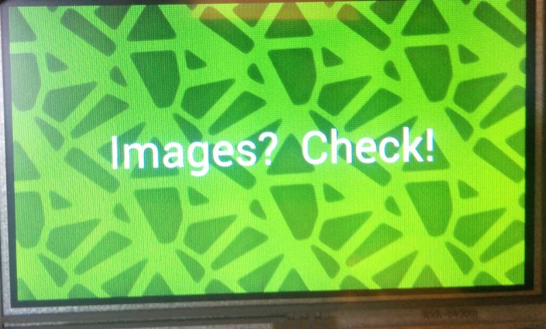

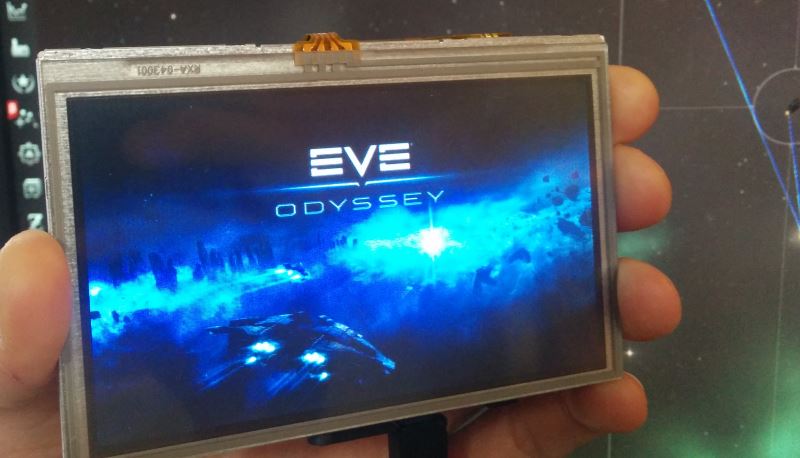

Yes!  I'm just working on that this weekend and here is a screenshot (again, with my unfortunate phone camera).
This is a bitmap image being loaded into memory and then text being laid on top.  I don't have a micro SD card around (just ordered one off Amazon), so I wrote a quick program on my computer that converts the images to a byte array to store in the actual Netduino program.  I'm holding off on committing that code to GitHub until I can actually do file loading.  However, I don't expect any major stumbling blocks.

Edit:  Just got game Gameduino logo demo going.  Attached screenshot above.
Edit 2:  Just added JPEG decoding.  Got stuck on something *really silly* for a while >.<

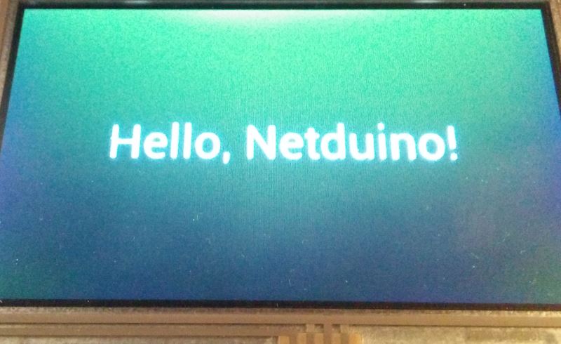

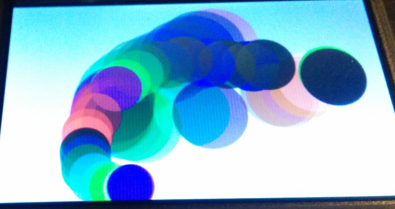

I've been hacking some more with my Netduino and have had some success with connecting to the Gameduino 2.  I'm not done porting yet, but I thought it might be useful and someone might have some fun with the examples I have completed.  Right now I have most of the basic examples up and running, including Hello World (text), Blobs (touch screen and shapes) and Simon (sound and touch targets).
https://github.com/g...eduino4netduino
I've attached two very unfortunate pictures below, but they sort of get the idea across.
In case you were wondering if it was possible, or even practical, the answer is yes!  Some special considerations have to be made for speed, but the Netduino does a pretty good job.  I'll be finishing up porting the library and all of the examples over the next week or so.

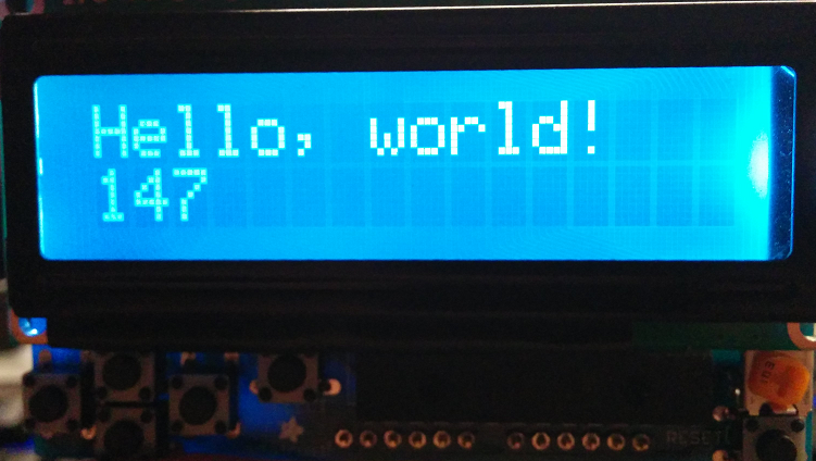

I wrote a program for using the Adafruit RGB LCD Shield some time ago.  I've recently been playing with embedded development a bit further and decided I should open source the class library in case anyone is interested in it.
I've uploaded the entire project (both a class library and an example program) to GitHub here:  https://github.com/g...shield4netduino
