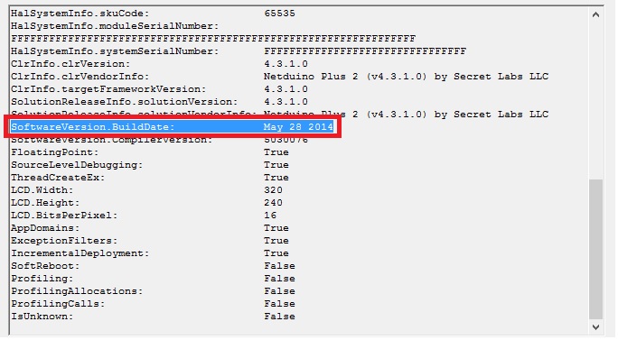

#63294 How to read SoftwareVersion.BuildDate(in Device Capabilities) through code
Posted by jiwonoh on 29 June 2015 - 04:55 AM in Beta Firmware and Drivers
Dear
I tried to read SoftwareVersion.BuildDate in Device Capabilities function provided MFDeploy Tool.
I searched assemblies, but I cannot figure out which one provide it.
Regards,
Jiwon
