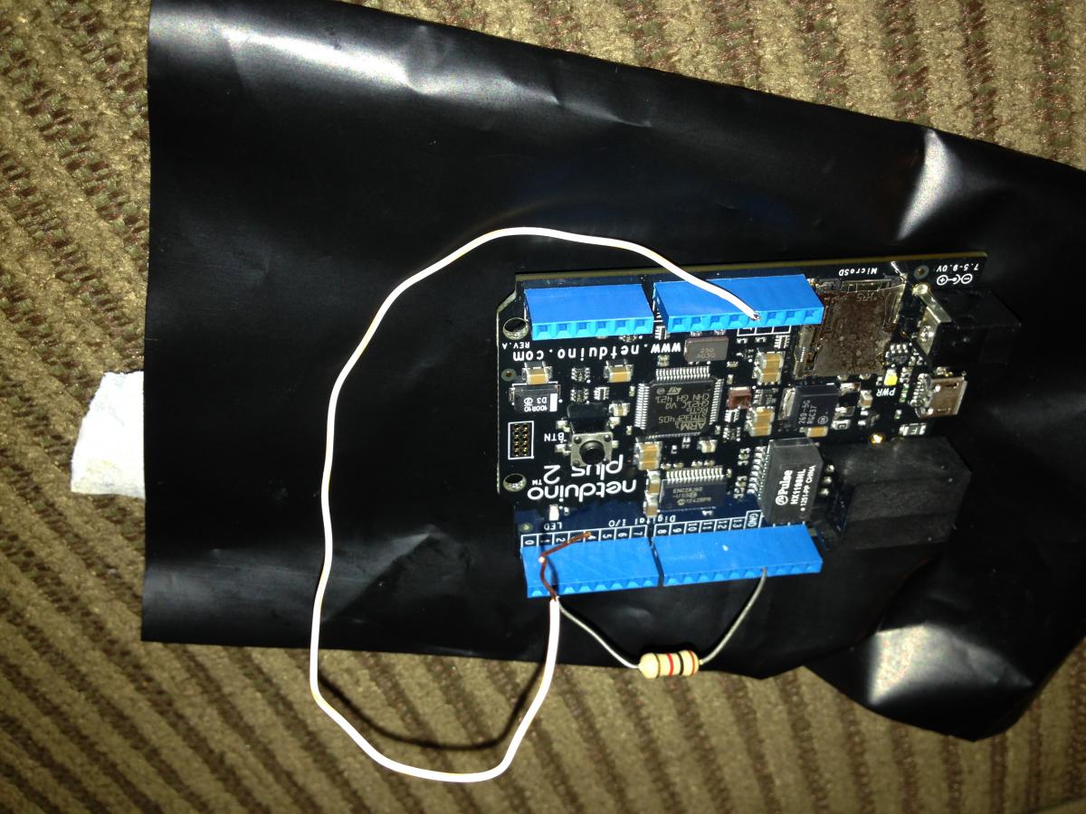

I'm trying to use a netduino plus 2 to act as a very simple monitor for a momentary switch.  Basically all I'm trying to do is when the switch changes states, post to a URL being monitored by an HTTPListener in an app on a pc on my network.
To test this, although I realize it's not the ideal test bench, I have simply put a pulldown resistor between GND and D1 and then used a short length of bell wire to short from 3.3v to D1, just in order to test.  Now, I realize this is not an ideal situation and I have some more supplies on the way in order to test in a better bench environment.  However, I am seeing behavior that seems bizarre, even given the bounce I would expect from using a wire as a switch and I feel like I am just doing something very basic very wrong.  I have attached a picture of my netduino physical setup - I currently am using a 1k 5% pulldown resistor, I started out with a 10k.  My code is below.  What I am seeing is one of several things, somewhat randomly:
  • If I do nothing but turn the LED on or off in the interrupt code based on the status of D1, everything is wonderful - every time I touch the wire to the D1 leg of the resistor the light turns on, and every time I take it away the light turns off.
  • If I create a URL and post to it on each interrupt as in the code below:
    • Occasionally, it will work fairly well.  I may get 15 or 20 hits to the HTTPListener each time I touch or take away the wire, which I would expect without debouncing, but it works.
    • Sometimes, I touch the wire once and I get continuous interrupts, with the light constantly flashing and the HTTPListener getting hit over and over again regardless of whether I then take the wire away or touch it
    • Sometimes, the HTTPListener gets the appropriate number of hits when I touch and take away the wire, but the light stays on constantly
    • When I get a constant stream of interrupts, they all seem to have the same time.  I'm not totally positive of this but I saw it at least once
I've been programming for quite a few years and judging by the random behavior I'm getting, I feel like I must be fundamentally misunderstanding the interrupt process, or missing an initialization, or that I am making some sort of grave hardware mistake.  Again, I understand I should have a breadboard and switch but from what I've read of the "experiment with a Netduino" posts out there, what I'm doing doesn't seem that fundamentally flawed that I should be having this many issues.  I'm hoping someone out there can tell me what it is I'm doing wrong.
