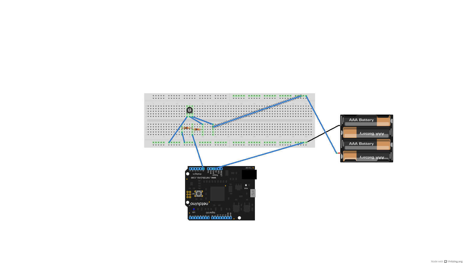

Hi, I've attached the FZZ file as a ZIP. The IR Compound Eye is not a component in Fritzing so I replaced it with a POT. The left wire being ground, the second wire being IR Sensor output and right wire being Positive. When I connect the middle wire (sensor output wire) and ground wire directly to a voltmeter instead of the Netduino all the Analog pins register as 1023, despite when measuring the directly with a multimeter the voltage is between 0.8V and 2.8V depending upon if I cover the IR sensor or not, so I know the sensor on the IR Compound Eye is working. Thanks, Xocai

I thought I attached the fzz file but just realised it's not an allowed type. Here is my circuit with the above issue I described. Thanks.

Hi All, I've been doing some testing with my IR Compound Eye from http://arduino-direc...ct_detail&p=249 and I have the issue that when I connect the IR sensors to any of the netduino analog inputs they all read 1023, I read them all at the same time. I can't power this off the netduino as the IR compound eye needs decent current to power the IR emittors but I'm not currently using them. I've attached my setup diagram (but put a potentiometer where the eye goes). I've checked the supplied battery voltage in with a multimeter is 4.8V and if I connect my multimeter to the cables running to the netduino A0 and GND I read between 2.8V in bright light and 0.8V when I cover the sensor so I know the voltage is in the correct range. It's really confusing as the Analog inputs work fine off the 3.3V with other sensors. I've read on this forum that putting 5V on any analog input does this but I know for a fact I'm putting between 0.8V and 2.8V nowhere near 5V. Is this a known issue? Or am I doing something completely wrong? Thanks Xocai
