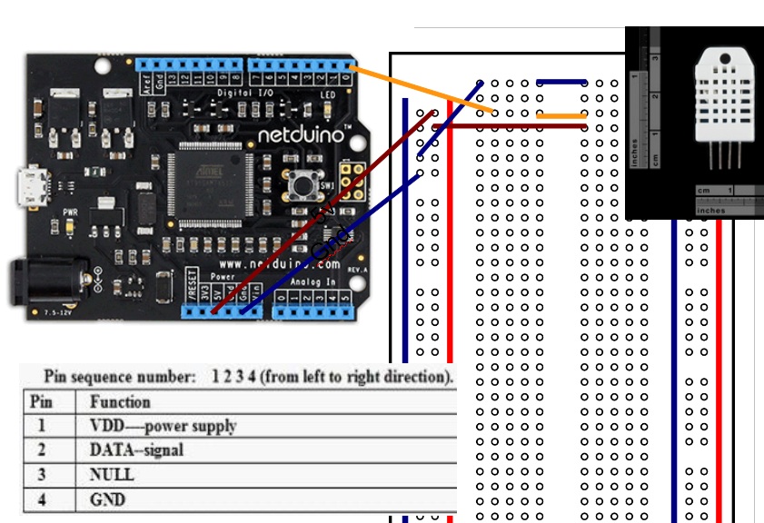

Posted by rex64 on 03 January 2012 - 03:53 PM in General Discussion
See attached. The left to right goes from bottom to top starting at the 4th row. :)
#22377 Convert to C# Humidity and Temperature Sensor - RHT03 RHT-22
Posted by rex64 on 03 January 2012 - 04:22 AM in General Discussion
The USB power light (white) goes dim after about 1 second of plugging in. I think Something must be wrong. I do not know where to hook up the resistor yet, so I just used the built in. Am I supposed to use digital? And is it ok to use the gnd and 5v on the Duino to power?
