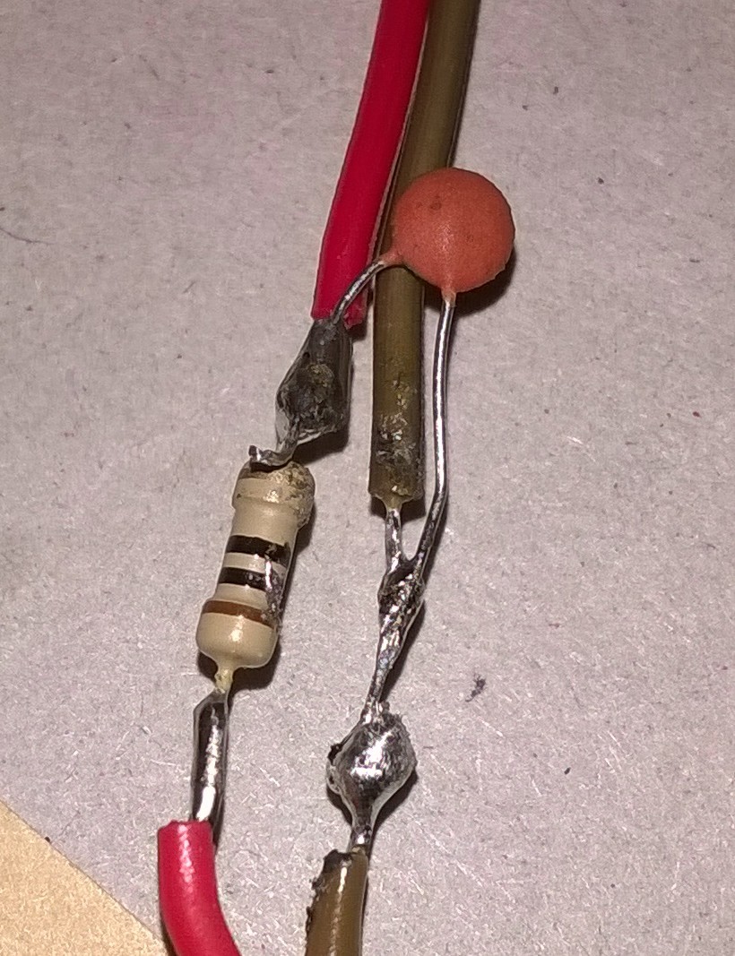

And if a low-pass filter is installed in the GPS module´s power supply ripple should also not be a problem. How do you set up the low-pass?
I used the same wiring layout as shown in your pictures previously:
Which is really strange, because it works for you - but I've now tested it on 2 N+2 boards and get nothing at all!

currently my N+2 with the Adafruit Ultimate GPS is working in 99% of the tests. I added a low-pass filter (10 Ohm resistor/47nF capacity) into the power supply and now I get a sat fix in most cases. Also, I have the backup battery installed which somehow makes the whole thing more stable.
Thanks for the heads up!
How much would you say having the battery increases stability by?
I've implemented a low-pass filter as you described (10 ohm in series with the GPS, 47 nF in parallel), and it has improved things (it sometimes works now!), but it is still very unpredictable.
As far as I can see, your implementation using the battery is the only significant difference.
