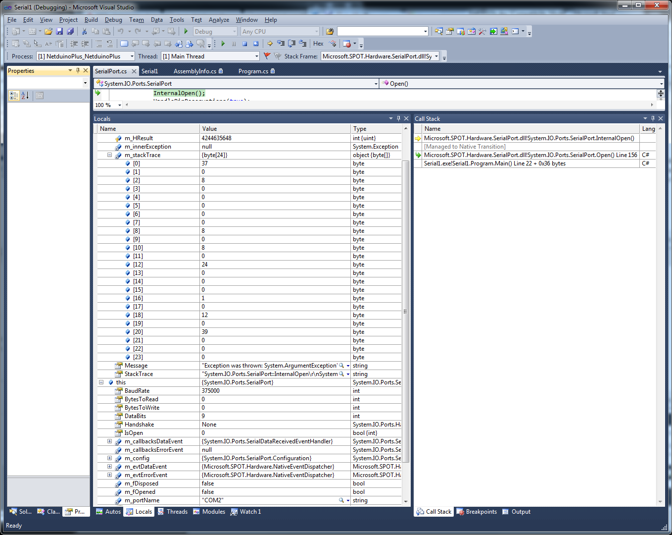

Hi Chris, Thanks for the good suggestion, and also for the friendly welcome -- I'm looking forward to doing some good work with this cool platform. Unfortunately however, it seems that it throws exactly the same exception at exactly the same point for COM2 as for COM1. I attach an image of the debug window in case it gives clues. Probably the driver doesn't support this feature of the AT91SAM7X USARTs. I assume the next step is writing my own unmanaged code to interact with this? Since I'm new to this environment, any tips for this (or any other approach) would be most welcome. Thanks again! Howie
