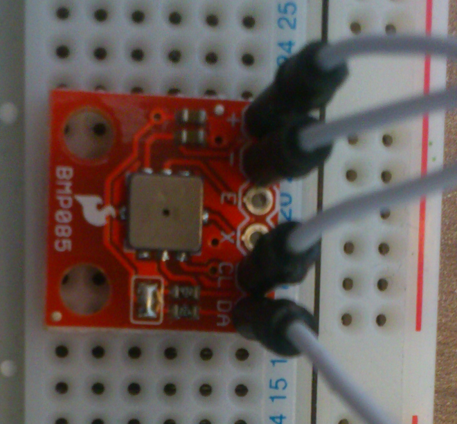

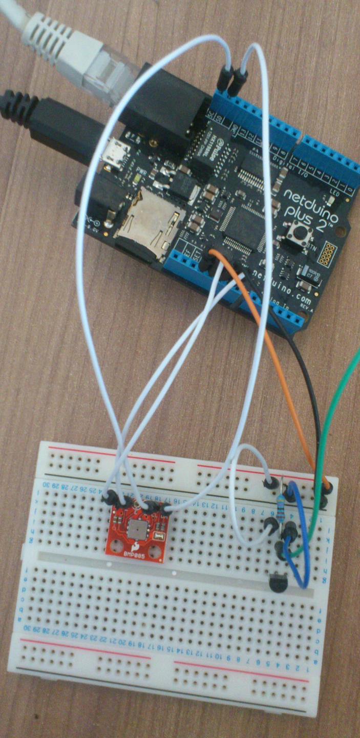

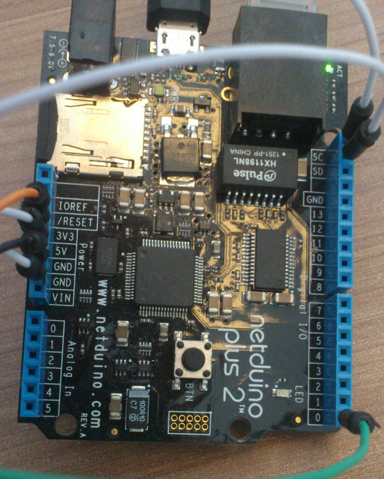

So something wrong with my wiring? I just took some pictures of my wiring, hope it helps.
Only mind the white wires, the other ones are for my OneWire Temperature sensor. (More here)
I tried the wiring schema Danger provided:
  • Sensor Pin VIn --> Netduino Pin 5V
  • Sensor Pin GND --> Netduino Pin GND
  • Sensor Pin SDA --> Netduino Pin SDA
  • Sensor Pin SCL --> Netduino Pin SCL
But my sensor shows slightly different labels.
I did it like this:
  • Sensor VCC => NP2 5V
  • Sensor GND => NP2 GND
  • Sensor DA/SDA => NP2 SD
  • Sensor CL/SCL => NP2 SC
Any thing else I could have screwed up?
Thanks in advance!
