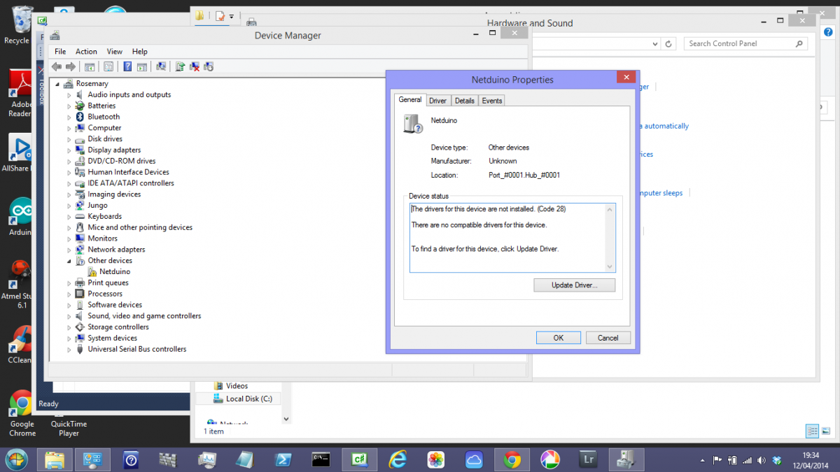

#57501 Windows 8.1 or Windows 8.1 Pro
Posted by V64 on 12 April 2014 - 05:04 PM in Netduino 2 (and Netduino 1)
Chris,
Thank-you for your help - I have been responding to your suggestions in the context of my first  problem that my laptop running w8.1 does not see the Netduino - and cannot find/install drivers - and Microsoft's device manager cannot find drivers.
In this context I do not see why the firmware version or the SDK are relevant - microsoft tools cannot talk to the (version1?) Netduino - or am I missing something?
Anyway (ON MY LAPTOP)  i uninstalled MIcroFramework sdk 4.1 and checked that I have  Netmf sdk 4.2 installed, and Netduino SDK v4..2.2 - I now get the response 'Project Type not supported by this installation', and I cannot now load the Solution!
How do tell which Netduino board I have, and what firmware is installed? I thin k I need some help to get back a known state!
I have to say I more confused than when I started! The board's mfdeploy 'ping' response (in OSX/parallels/w8.1 Pro) has changed from TinyClr to TinyBooter - so I can no longer checkout the problem of being unable to run the board in OSX/... (my first problem).
David
#57486 Windows 8.1 or Windows 8.1 Pro
Posted by V64 on 11 April 2014 - 06:49 PM in Netduino 2 (and Netduino 1)
OK here is:
Attached is a screenshot of the Device Manager
the Control Panel>program>features shows: Netduino sdk V4.1.0 (November 2010 refresh)
Thank-you
