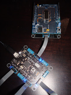

I can access my 64Mbit Flash shield using this SoftwareSpi class I wrote. The sample program below just reads an ID from the Flash chip using SPI. This is going to be a lot slower than hardware based SPI, but useful until that work is finished. You may be able to access other shields using SPI using this class.
I got this working in the first few hours of bringing the Netduino Go home from the Maker Faire Bay Area show. It was nice meeting Chris and getting to hear about Netduino Go's history and specs. Thanks Chris!
-Dave VW

Hi Dave, Cool. Sometimes I get so wrapped up with super-fast SPI-using-DMA and the such that I forget to recommend bit-banging as a possibility. Adding additional flash in this manner is a slick first project. BTW thanks for stopping by at MakerFaire...good to meet you! Chris
